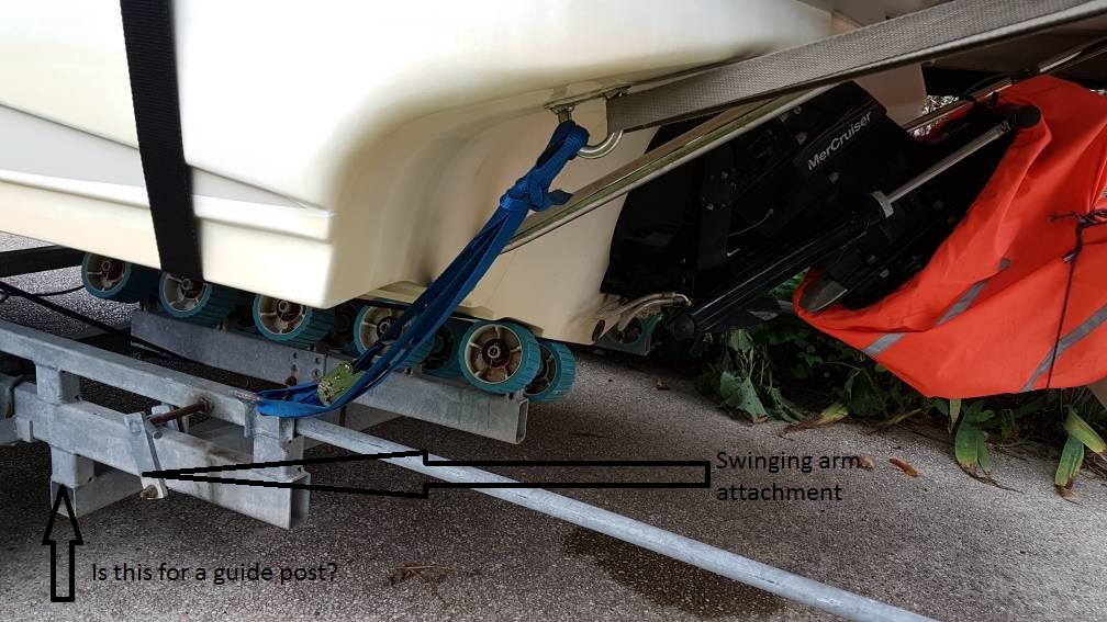

To get more nose weight normally between 50-100kgs, one would move the winch post. This in turn would either take weight off (move to stern) or add weight to tow hitch by moving it forward.
I've tried to blow up your set up photo at the beginning of this thread but it blurs up, so I can only assume you have a roller coaster of some kind and I am unable to see if your winch post is movable forward.
If it is all you have to do is undo the bolts and bring it forward in short stages. A word of warning though. Some tow bars have a limit on their down weight. My Discovery can have 150 kgs I think but the Rav only 60kgs. It depends upon the tow bar and then the hitch. Oh and you may have to move the bow keel roller as well.
Hth. :)
by ChrisH » 19 Aug 2017, 21:36
Ianfs wrote:Hi Chris
I hope you see this post I didn't want to hijack Argonauts topic.
Hth. :)
Thanks Ian. So yes it is a rollercoaster setup. I have just about half an inch of the hull overhanging the last roller. Can t move the boat forward any more otherwise the transponder will.catch the rollers.
When I had the trailer serviced before going to annecy. They moved the axles back abit but are reluctant to go any further. They say I will.get wagging, which surprises me with a twin axle setup.
So do most peope.have the transom forward of the rear rollers then?

I'll take some pics tomorrow and post.
I have al.ost no nisr weight at all.
Right now on holiday I have a 25kg bag of sand on top of the spare wheel and a load of luggage in the bow. Estimate I have approx 80 to 100 kg of nose weight now and car is running much better.

Here's the stern setup on the trailerImageImageImageImage
by Ianfs » 21 Aug 2017, 19:10
No, most are just like yours.
Right well, if I've got the bits in the picture right, you should be able to move the rear swinging arm forward a short way in order to move the boat a little further forward. You may need to either scroll down the photo or open it up.
There is one further consideration to take into account, which I have just remembered towing a twin axle trailer with a saloon/estate car and that is the tow ball height. A Land Rover, for example has a higher ball height and therefore the trailer sits more naturally when attached with both axles taking the same load. When I towed with a BMW, the natural sitting position of the hitch was about the same as the tow ball, consequently very little downforce and extra load on the front tyres.
I'm sure I read in one of your posts that your front wheels are taking more weight than the rear, is that right or am I dreaming?
Oh and a quick tip, buy a cheap set of bathroom scales and stick them under the jockey wheel. :D
