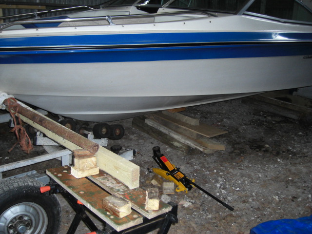

Ummm, not strictly true. If you ever need to make a recovery or a launch for that matter without the whole trailer submersed, as you may have found out since but when your bow hits the first set of rollers (that's the rear most rollers actually) on the rear swinging arm the beam of the arm will tilt forward, then as the boat is driven on to the further rollers, which by this time should be sticking up, the whole swinging arm flattens. On a launch if the rear beam of the arm was stopped from moving forward the boat would enter the water at a steep angle.
However if you look at the picture I've posted of the boat in the barn coming off the trailer, the swinging arm has positioned the rollers correctly, however the beam hasn't moved much. Consequently I think you would only need to move the arm a little to achieve your goal.

However, I was surprised at how heavy the bow of my boat is when I took it off its trailer a couple of years ago and it's only a lightweight bowrider. The stern block support was virtually under the engine, but the weight at the bow was awesome. In fact I started off with a scaffold pole to hold the bow off the trailer and had to add a length of 4x2 because it was bending too much.
