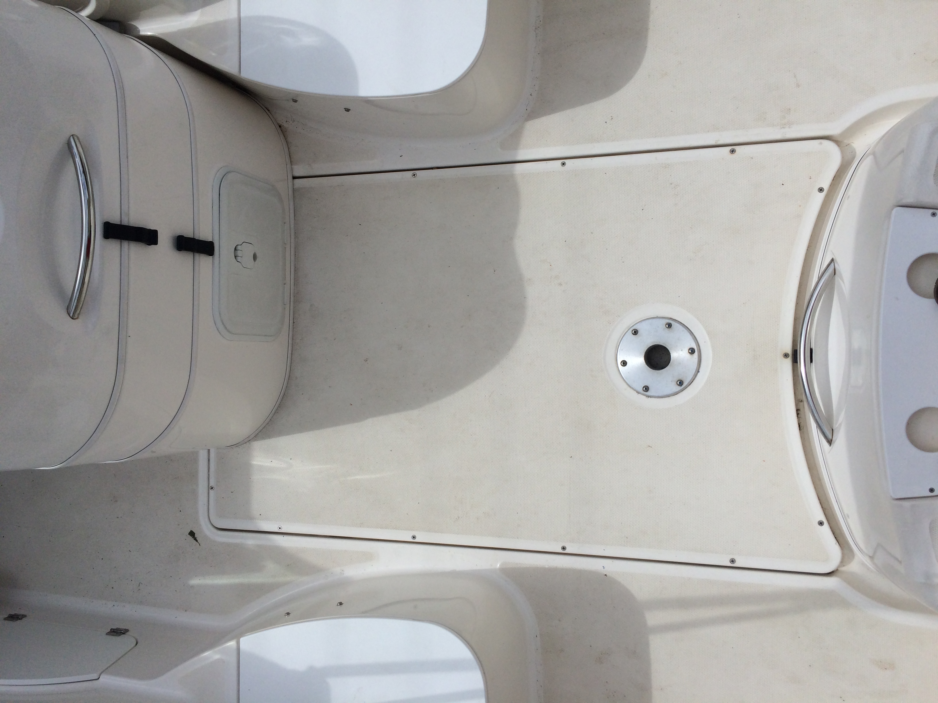

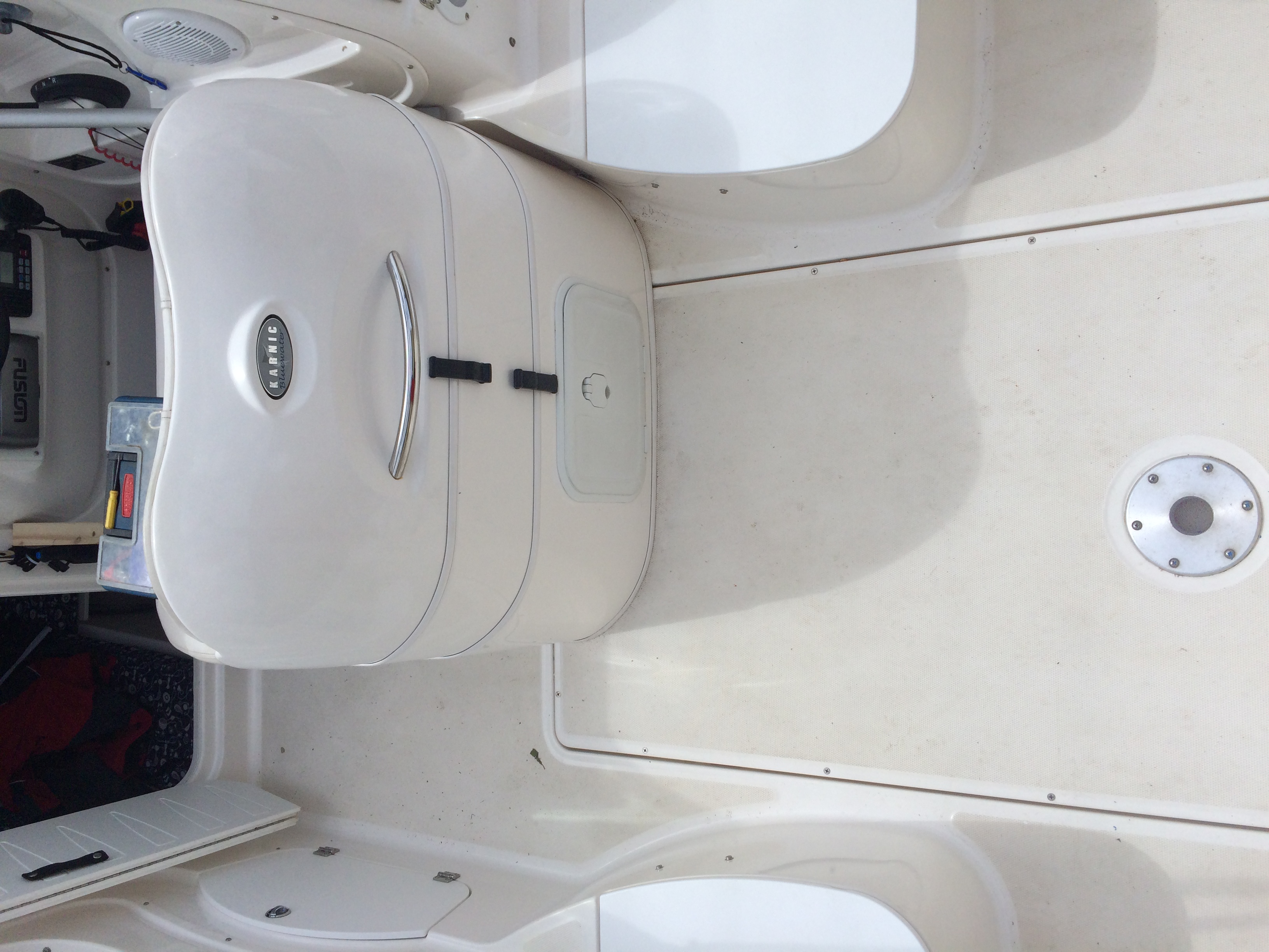

MY fresh water pump (sink &Shower) has stopped working- contrary to the owners manual stating it is accessible it seems someone at the factory decide under the floor was better, so now I need to remove a few large items to gain access -

Back to the repair, Yesterday was 'one of those days'. I wish the Karnic engineers had stuck to the plan and installed the pump where it should have been (accessible from an opening side wall panel). Removing the pod was a nightmare, to get to deck screws the hatch doors needed removing, drain pipes disconnected, storage cleared, driver at arms length etc.
pushed forward screws removed on the floor lid only to find it stuck on, table support (fuel sender port) removed showed a lot of muck so a crowbar was employed, after much grunting she final came free to reveal 2 things, Half a bucket of rotting matter, and no water pump. :evil:

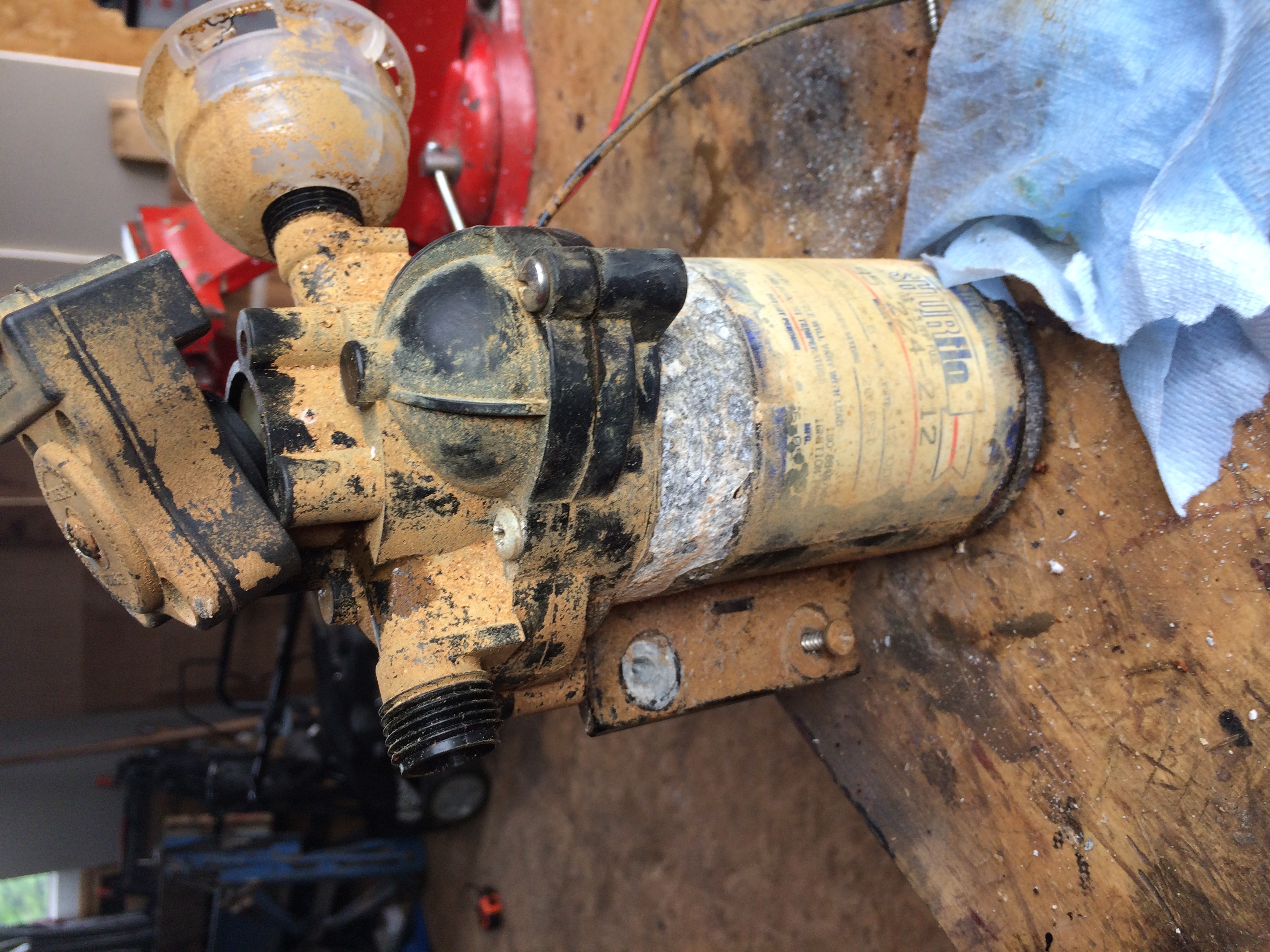

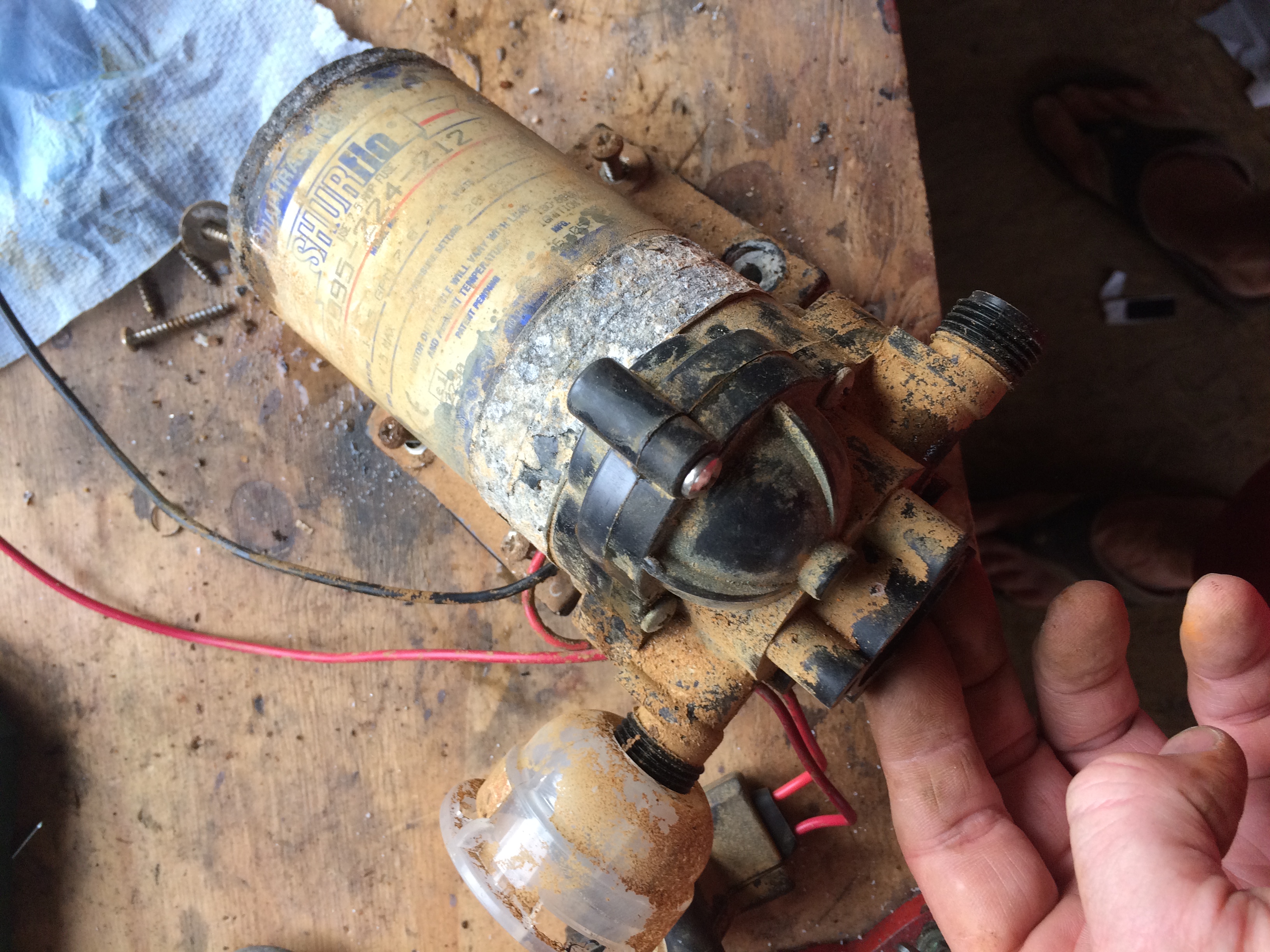

but I could see it located under the cuddy, access from a small hole and 2 foot down in the forward bilge. No wonder the pump has failed, at some point it was submerged in muck and salt water. The pump itself is just about salvageable. electrics were shot with rust & water and the flow sensor knackered but Ive managed to clean them up re spring the sensor and she works as it should. I could replace the sensor mechanism at £15 but if the main diaphragm fails, at £20 I may as well buy a new pump at £55, so Im going to go with seeing how long it lasts, then replace as required.

Eeyyyooo! That pump looks a tad mucky. One good thing about it though, had the pump not failed you wouldn't have known about the muck in the bilge. :)
What about extending the pipework and the electrics and mounting the pump in an accessible place?

yes I could do but i figure its just best to put it back for now then move it when it eventually fails. i.e. by taking it out a second time I'll be really annoyed by then :lol:
