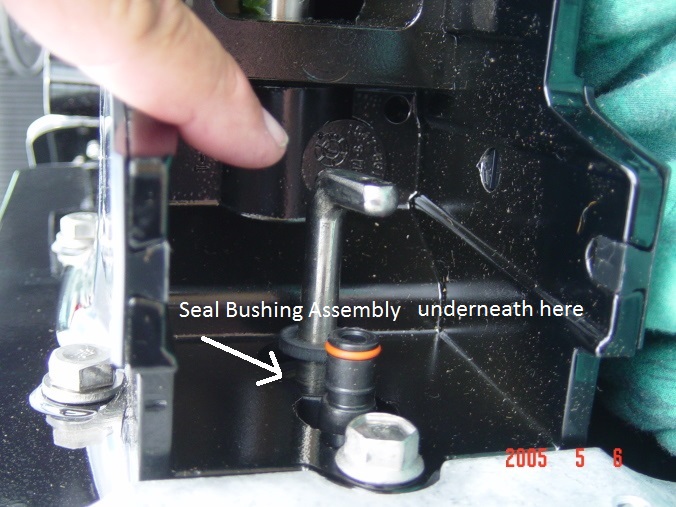

Not sure how you did this. The Shift shaft seal is inside the lower gear case. Hears a picture of an alpha one and although they are not exactly the same they have similarities in this area. This photo was photo shopped for someone else so ignore all the other indicators.
Lower gearcase housing showing possible leaks.jpg (120.6 KiB) Viewed 24428 times

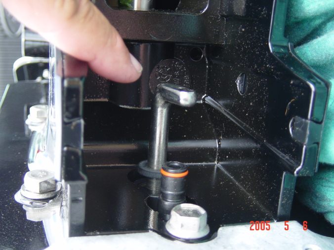

Ian - I was refering to this bit - I thought it was the shift shaft lever or may be Gen 2 is different? visible from the back of the drive when raised with the speedo seal unit
I can see what you are getting at. That is the lower shift shaft but its not the shift shaft seal (sometimes known as a shift shaft bushing assembly. Not to be confused with Shift Shaft Bushing which is in the bell housing :D ) . On the Gen 11 as I said it is slightly different to the Alpha One, the seal assembly is below the plate shown although on the Gen 11 it does stick out a little. If you were able to see inside where the seal is then great, but I'm not sure you would see a weep clearly. Mind you having said all this I do remember when working on a mates Gen 11 last year, it was clear that oil was seeping from the drain hole, if yours isn't then clearly its not this. See arrow for the Shift Shaft Seal Assembly............
