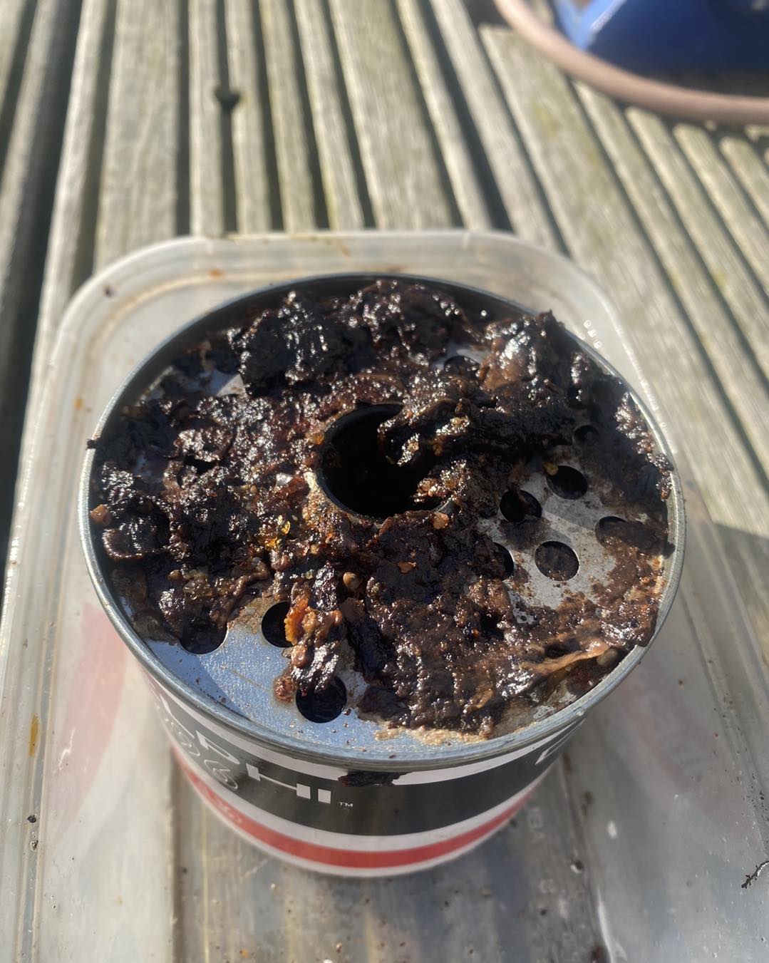

What is Diesel Bug?
Diesel bug is essentially a colloquial term for the microbial growth that occurs in stored diesel fuel, particularly when it is contaminated with water. These microorganisms, including bacteria, fungi, and yeast, thrive in the water and organic matter found in diesel. They pose a significant risk, leading to sludge formation, fuel spoilage, and ultimately, engine failure. I’ve seen first hand how a small oversight regarding fuel storage can lead to costly repairs and downtime.
Why Should We Care?
The effects of diesel bug can be insidious. Not only can it clog fuel filters, but it can also corrode fuel tanks and other components, leading to expensive replacements. Further, operational efficiency can plummet as engines struggle to perform with contaminated fuel.
Protection Strategies
Fortunately, prevention is possible, and it starts with a proactive approach to fuel storage. Here are several strategies that we recommend:
Regular Fuel Monitoring: Conduct routine checks on your fuel for signs of microbial growth. This involves visual inspections if you have clear glass or plastic bowls on your filters and potentially using test kits designed for diesel fuel.
Water Management: Ensuring that your storage tanks are free of excessive water is crucial, Keeping a fuel tank topped up can help prevent this.
Use of Additives: Consider using Additives specifically formulated to kill the microorganisms found in diesel fuel. Integrating these into your fuel management plan can greatly enhance your defences against diesel bug.
Filtration Systems: Investing in quality filtration systems can help to capture impurities before they make their way into your equipment.
