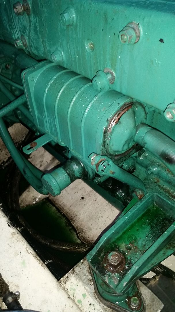

During this season I developed a slow oil weep somewhere behind all the coolers. The kind of thing that is a nuisance but not bad enough to interrup the season with. Also wanted to have the superchargers reconditioned. Electro magnetic clutch was being awkward leading me to disconnect the compressor belts.
Why is it on boat engines that not only is everything innaccessible, but you have to remove everything just to have a look-see?
So today was knuckle skinning day dismantling the port engine and removing compressors from both.
compressors / super chargers off and ready to be sent off.
Then came the laborious task of removing turbos' air intakes, various coolers etc to finally get to the oil cooler
and there is the slight oil leak. Looks like the end cap needs to be replaced or retinned
And all the coolant and oil back in my bilges :evil: So I'll have to redo the bilges again. Does my head in, I spent all last Saturday making sure the boat was clean and dry and spent hours in the bilges cleaning them out. Should have just waited :evil:
