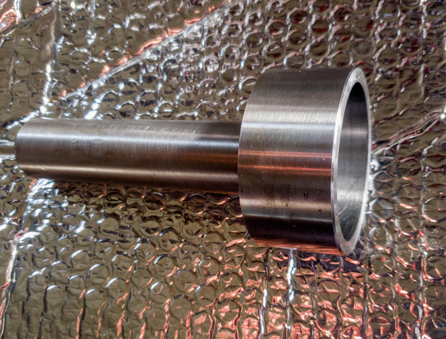

There is a special tool - but it costs £45
So had a copy of the removal tool made up in a lathe :
Works a treat removes and refits with zero damage.

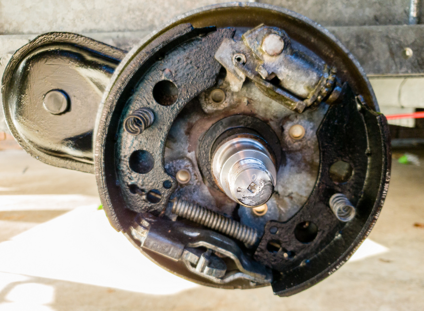

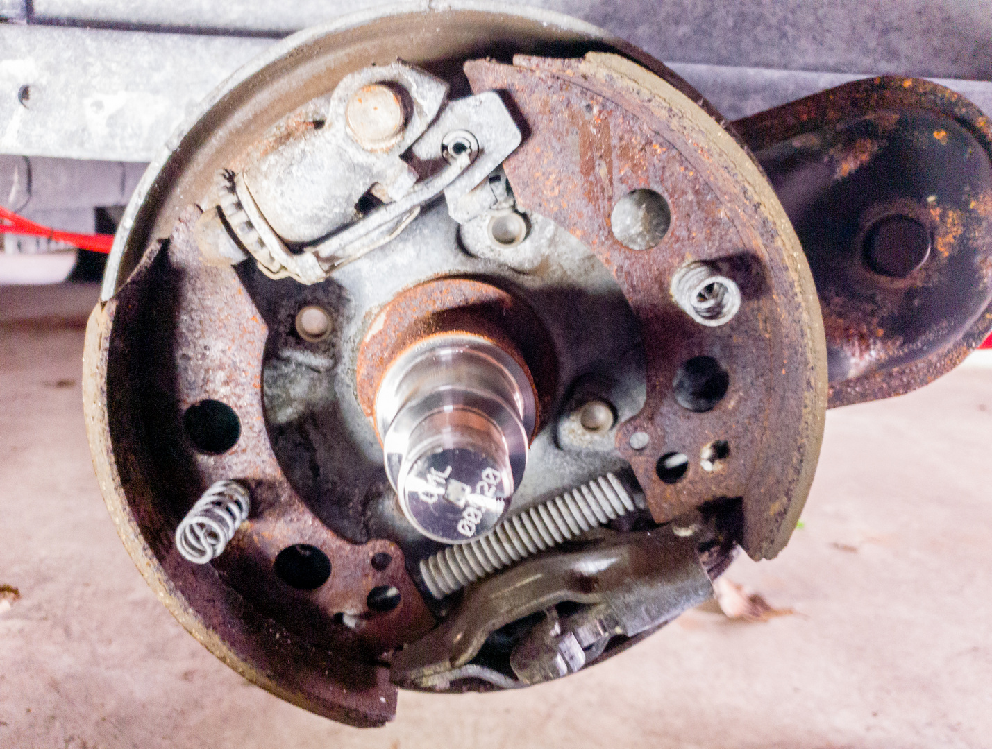

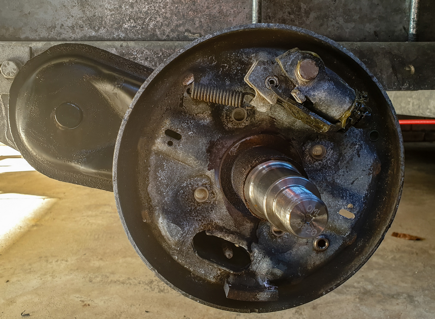

Now the unwelcome part ... You can see the corrosion of the brakes after a few months use, and also worrying was the rust on the swing-arms.
Drum removed.jpg (809.96 KiB) Viewed 29625 times
Stripped all parts out, degreased fully, then De-Salted with CHLOR-X, rinsed off. Cleaned inside drums with WURTH drum cleaner
The stub axle, main cross axle swing arms had significant rust on them …after only ½ a season …. It is absurd that Alko produces galvanized cross-beams & back plate, but the swing-arms are just pained with a thin matt black paint, the stub axle inside the drum is not painted at all ……. Both corroded significantly.
Also the brake shoes are only electro-plated not galvanized .. so they rust after the first dip in the sea.
Treated all rust with KuRust Rust converter.
Painted swing arms, drum, shoes and stub axle …… using Rust Buster EWM21 2-part epoxy paint … this stuff is 100% salt waterproof, and hard as nails.

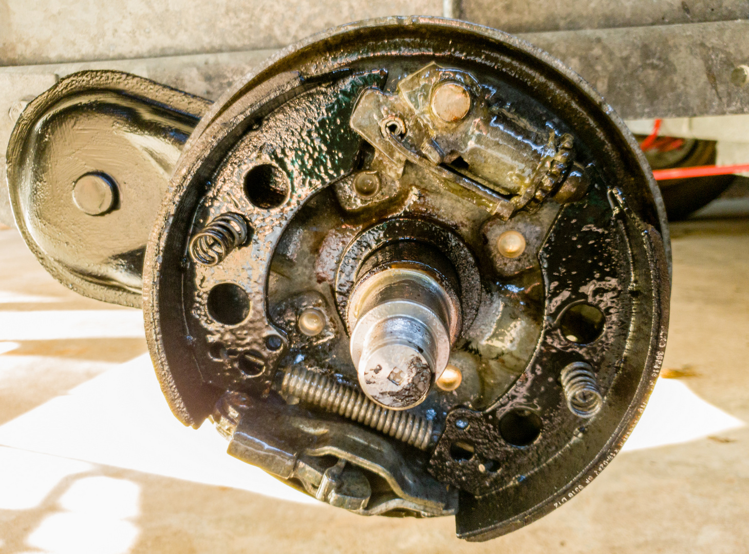

Before fitting the drums, I sprayed the backplate, springs, adjusters with Lanoguard marine & chassis liquid …. and coated adjuster mechanism in Lanoguard Marine grease.
Also sprayed the liquid on the rear of the back-plates.
This marine spray product sprays on easily then set like a wax coating, a bit like Waxoyl if you are familiar with that ...... but much superior performance

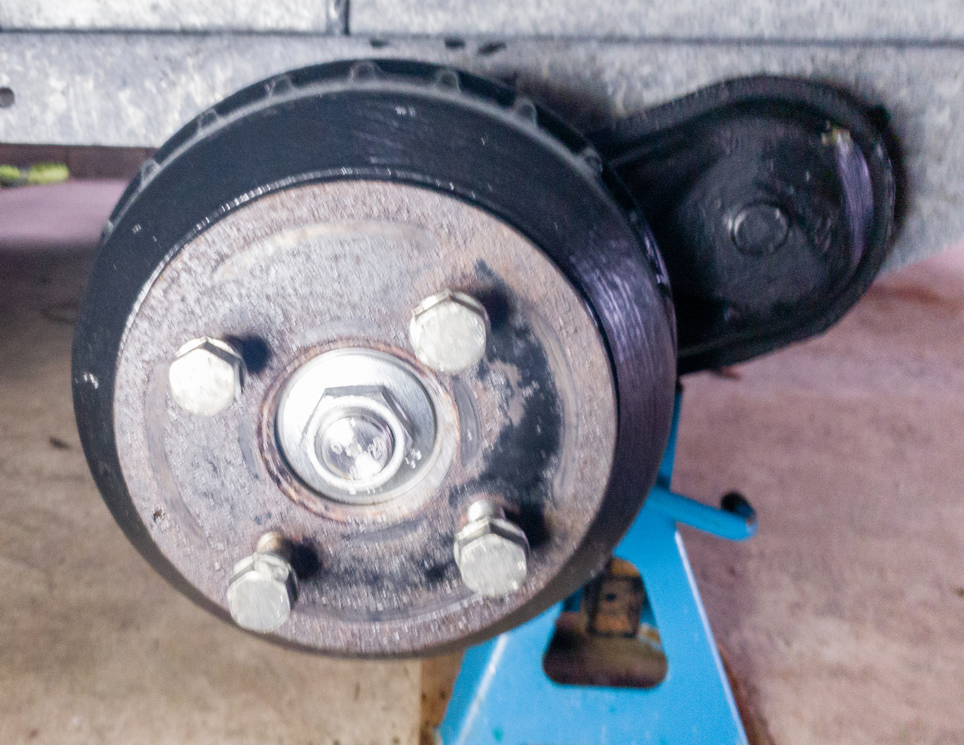

Putting the drum back on with new flange nuts is a new experience, always had taper roller bearings previously you install with end float and a split pin. These 'Euro hubs' use ‘sealed for life bearings and these are fitted with a one-time use flange nut, which you have to discard each time you remove, and they need to be torqued to 290 Nm, this was outside the range of my torque wrench …. Luckily picked up a big beast of a torque wrench off Market Place.
To reach 290Nm still need a long piece of tube over the torque wrench handle ….. it’s a lot of torque for sure.
Not sure I like the idea of no seals on the bearings …. I know they are classed as ‘sealed for life’ but that may work on a caravan, but being fully immersed in Saltwater each time I go out ….. can’t see them lasting too well. On another forum guys are talking on replacing after 18 months .... my Taper roller bearing were still good after 5 years - just replaced seals annually. On the Taper Roller bearings, I used to fit Bearing Buddies which kept a positive pressure on the grease. Did keep bearings good, but due to seal leakage, the backplates were really messy when it came to annual service.
