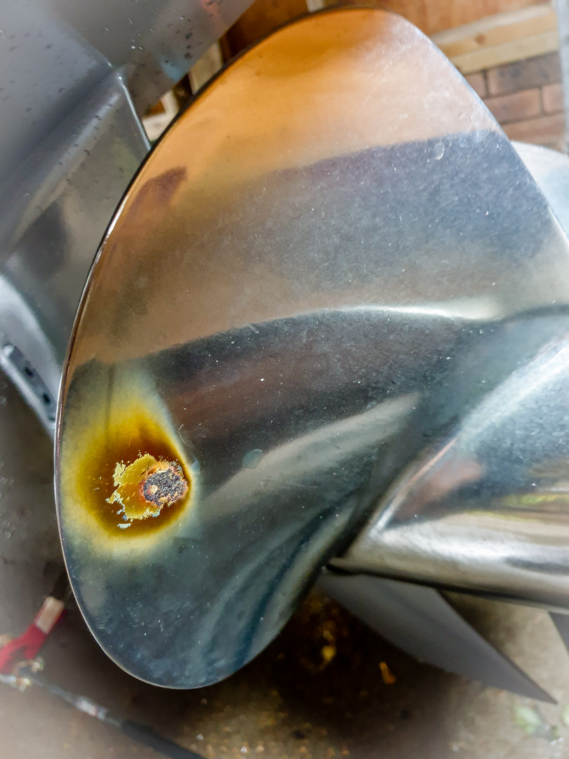

Just been in for 3 weeks in Volvo dealers - My stainless steel duoprop has a rust 'bubble', (see pic) and I was unhappy that Props were not operating in the centre of WOT band, after testing they agreed and swapped the props to next pitch down .... so will also see much more acceleration - and it had impressive holeshot already.

Glad all the niggles have been sorted successfully, strange to see a rust spot like that, any idea what will cause that?

It appeared on 1st run out .... I polished it off and it was pitted underneath.
It is a casting defect, must assume the factory polishing filled in hole and was not noticed.
I wanted local VP dealer to get in replacements in advance ... that was when all issue over not being registered came to light.
I carried on using ... would polish off the rust, but it rusted again as soon as it touched salt water.
£1400 a set of props .... so glad it was warranty.
I agree, very odd. So Argonaut, you think it was the casting eh? I have a question, I've always thought that high end Stainless i.e. 316, 304, whatever you want to call it is what I've known as "self healing" where any steel dissipates and the chrome within heals the wound. Sounds a bit like the new type of terminator eh?

I spoke to guys in Engineering they advised, likely a piece of casting slag has got into the mould .... should have been picked up during polishing or inspection ... or again at PDI.
