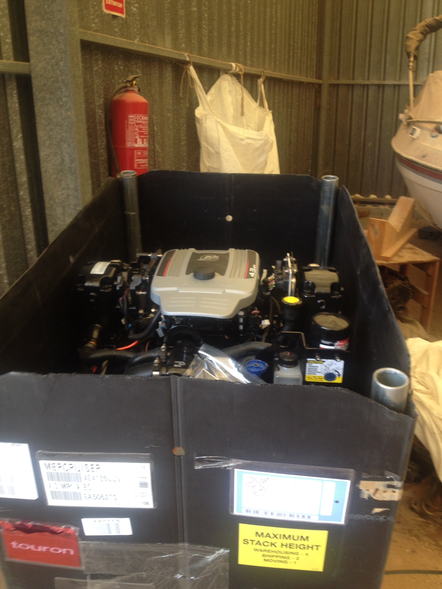

I had a new Merc 4.3, shipped from the states, when I bought my boat - the boat didn’t have an engine when I bought it, but it was the perfect boat for us.
There is a running in schedule for the engine and it should be in your Operating & Maintenance Manual under Getting Started. If you can’t find it mine went like this - 20 hour break-in period

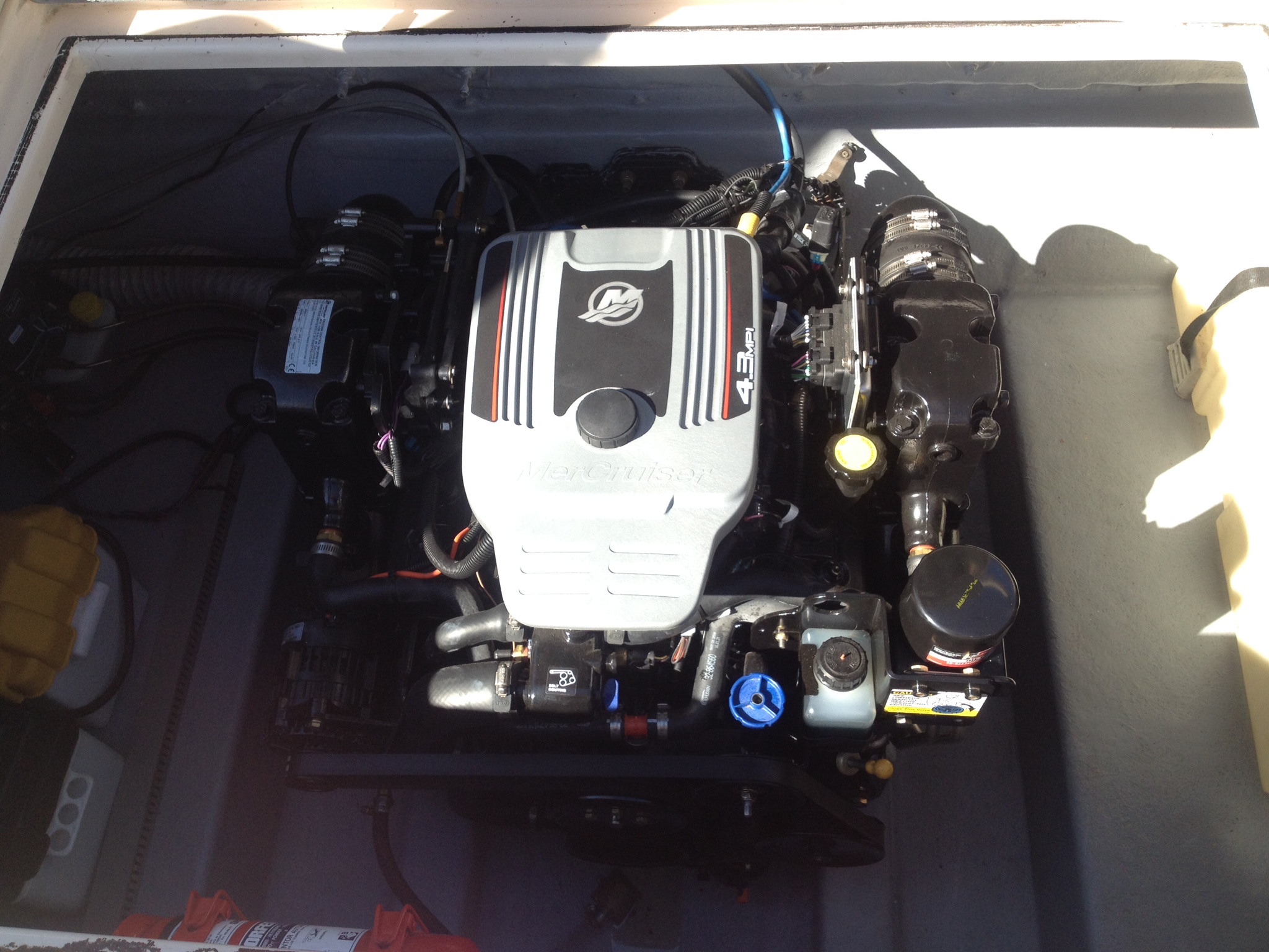

It’s important to remember to get the engine serviced one year from fitting or at 100 hours whichever comes first. I mucked up and thought it was one year from break-in and ended up nullifying the warranty - doh!!!
You’d think after 3 years I’d get fed up of looking at the engine - but no I can’t resist it :lol: :lol: . My excuse is I just need to let any residual fumes out of the engine.
All fitted and ready to go
Still can resist show everyone the engine when they look at the boat - love of my life, just don’t let the other half know
