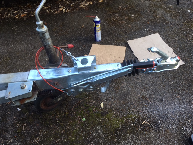

Just spent most of the day fitting a new hitch end to mine

I bought a complete new Knott Axle about 3 years ago and new brake cables. The Brakes and cables are now all had it because of the salt water. Even though I flush them every time
I have just returned from Indespension £145 lighter with a load of parts I don't think will last 2 years. This year I am going to spray the inside of my breaks through a little hole at the back with WD40 each time I get home from using it.
So with the new head this has cost me £ 350. Nice this boating lark
Don't much care about the actual braking efficiency as my Disco will easily stop my 1000 kg boat, I just don't want them all seized up.
