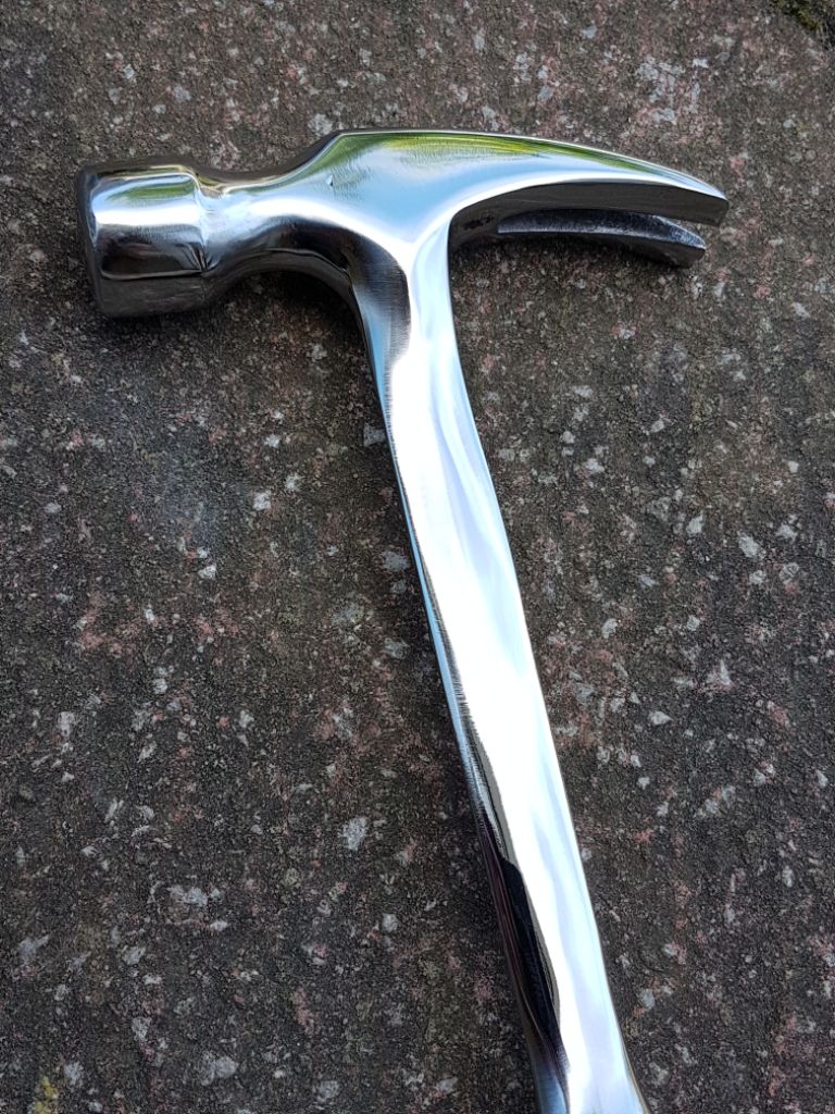

Ok so it's not a prop but I thought I would try my hand at metal polishing instead of gel.
Subject for this was my work hammer, could make a stainless prop look like a mirror.

Like the end result. How long did that take ??

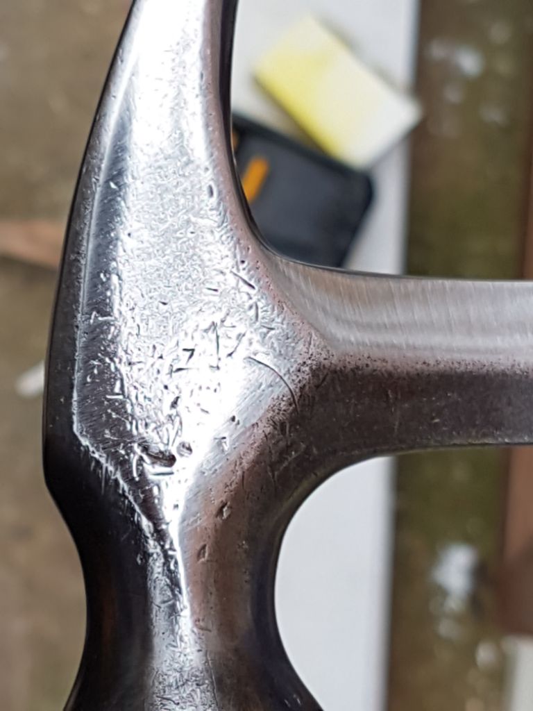

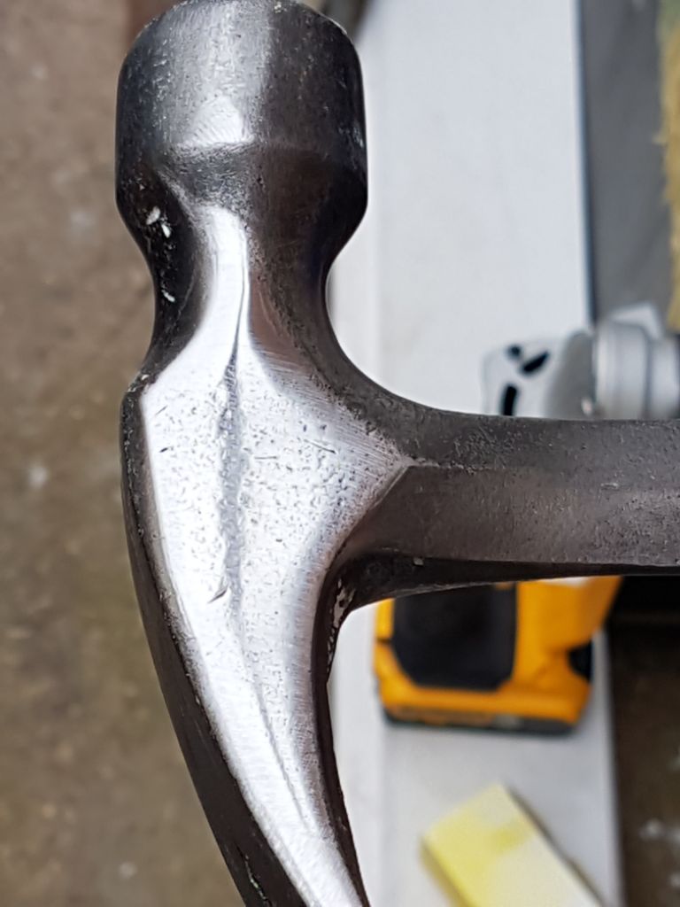

by Warpa » 08 Jun 2017, 09:17
It took maybe a couple of hours using an angle grinder. Flappy discs to take out the imperfections, fine grinder and a polishing wheel.
No metal polish involved.
