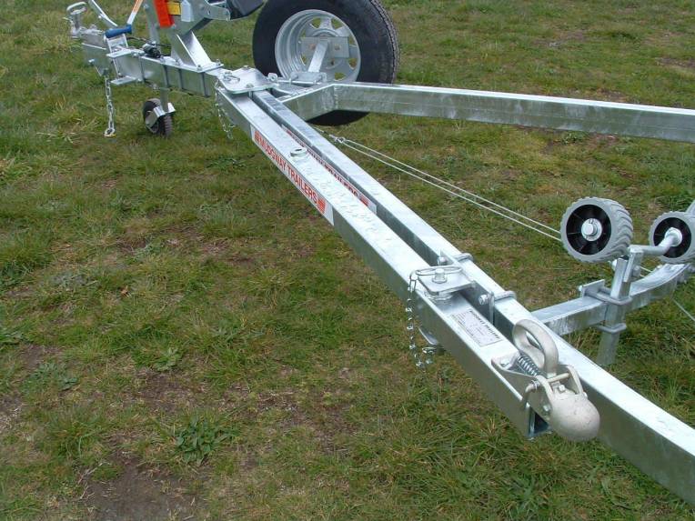

I would like something like the attached pic and have googled around but cant find something similar in the UK. Anyone done this or know where I can get one. If not I will have to try and make one.

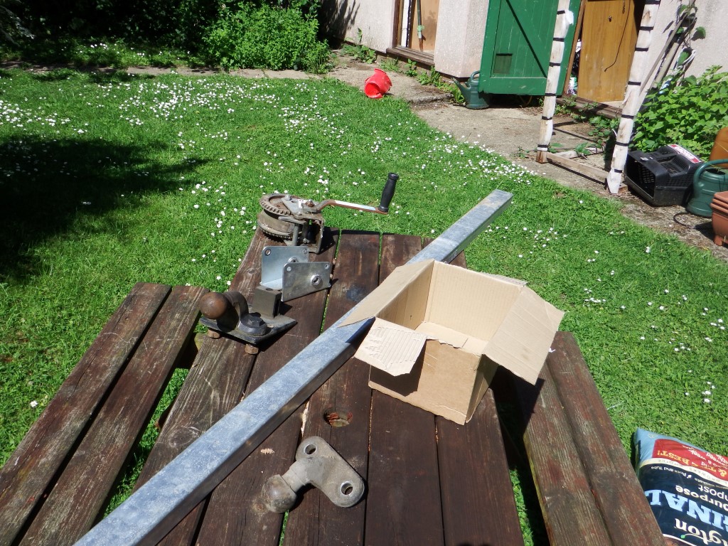

I have managed to find most of the parts I need at home and also from 2 old scrap cars I had (I seldom throw things away). Mine will use ball hitches to hold the tow bar in position when not in use and I can cannibalise an old winch for a bracket. And believe it or not I have a long piece of galvanised box section from when I made my poles for my trailers. If these parts work all I need is the actual hitch which I think are about £20.

Here are the parts I have scraped together

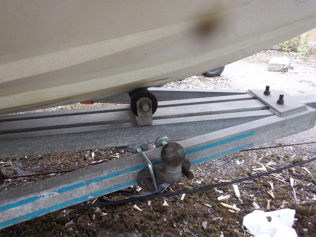

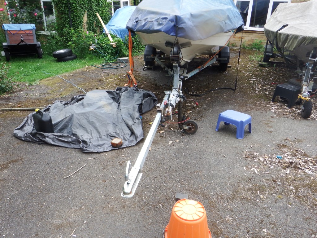

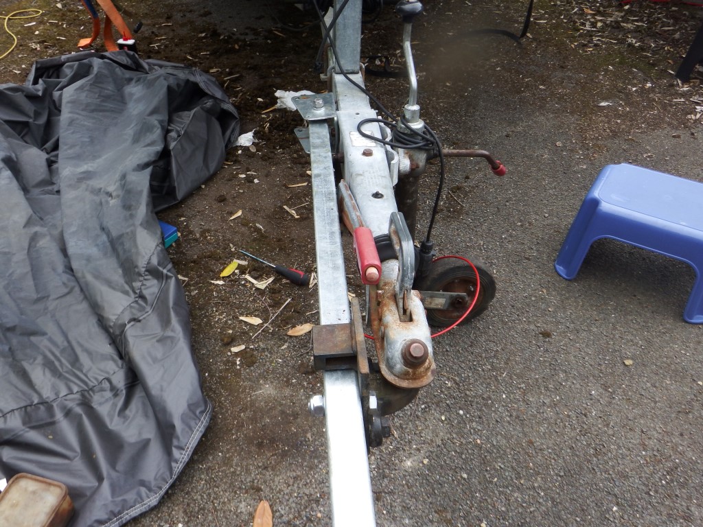

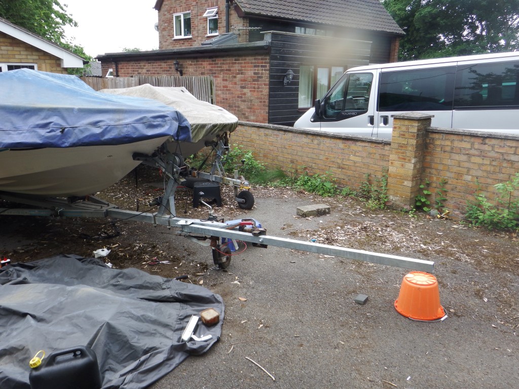

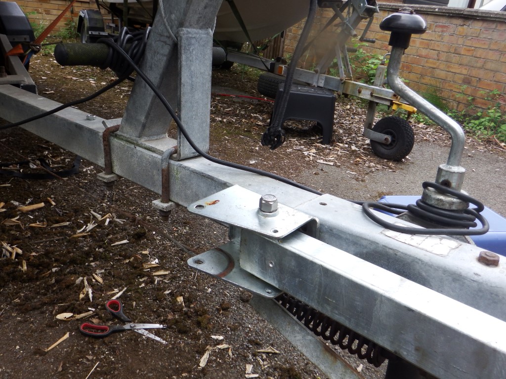

Well I have been on and off this job for a few hours doing other things but it is working far better than I thought particularly as I scavenged 90 % of the parts. Total cost will be £15 excluding the bits I had. This is the hitch and some bolts.
Here are some pics nearly finished.
You will see that I have clamped the hitch ball to the trailer so it is adjustable and also so I did not have to grill the trailer as it is galvanised and don't want to introduce a rust point.
The bracket is made from an old boat winch I had and the tow balls were from scrap cars I had in the graveyard.
All I have to do now is fix the hitch and adjust the ball on the trailer to suit the length I finish up at.
I think this will work quite well and will give me that vital 1400 mm ish more I need so I can drive the boat on and off with it still on the Discovery and keep the car out of the water
