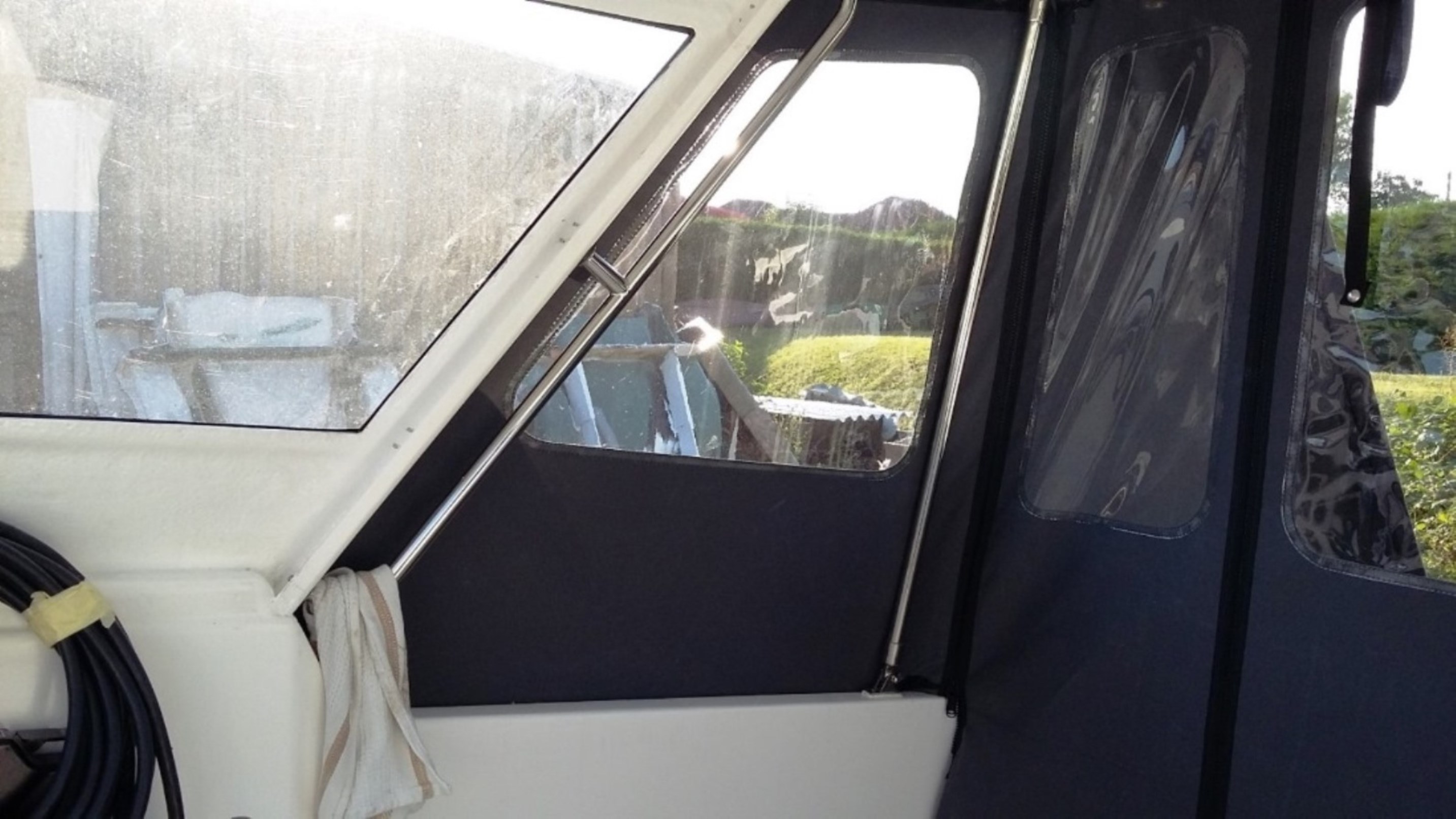

Hi Ian, I have already replied to your cover post, but if you did want to consider some form of cover/deck barter, the cover would be quite a lot more expensive than the deck - I am telling you that in case it convinces you that you may indeed want to give the matter further thought!!! I have now fitted two vertical rails from the hardtop down to the top of the coamings which define the W/H rear and will support the transverse partition. I have use Bimini swivels to fix the rails and when in the "open" configuration they lay down flat above the coaming and rest in another swivel. Geoff.

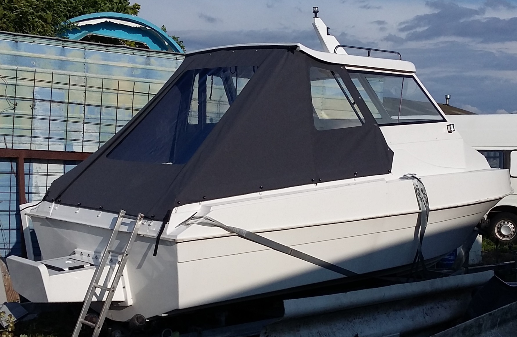

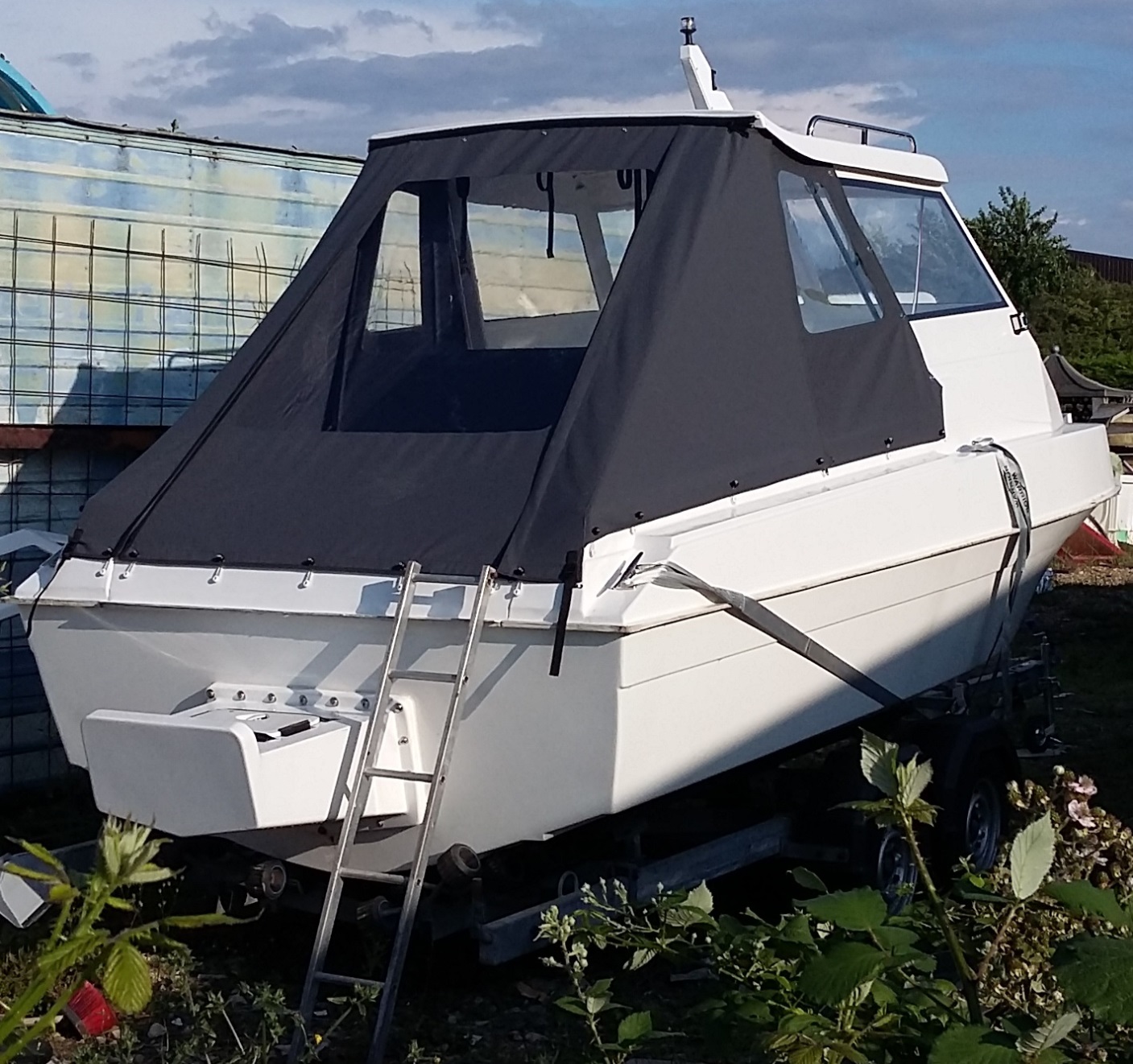

Boat now back with new canopy. Canopy in 4 sections. One side screen each side, one canvass bulkhead which forms an enclosed WH withside screens and a tonneau with a large visipanel from the WH roof t joined to the side screens and sloping down to the transom. I have also fitted a mast, nav. lights and bow roller. Same pics posted on WSF forum. Geoff.

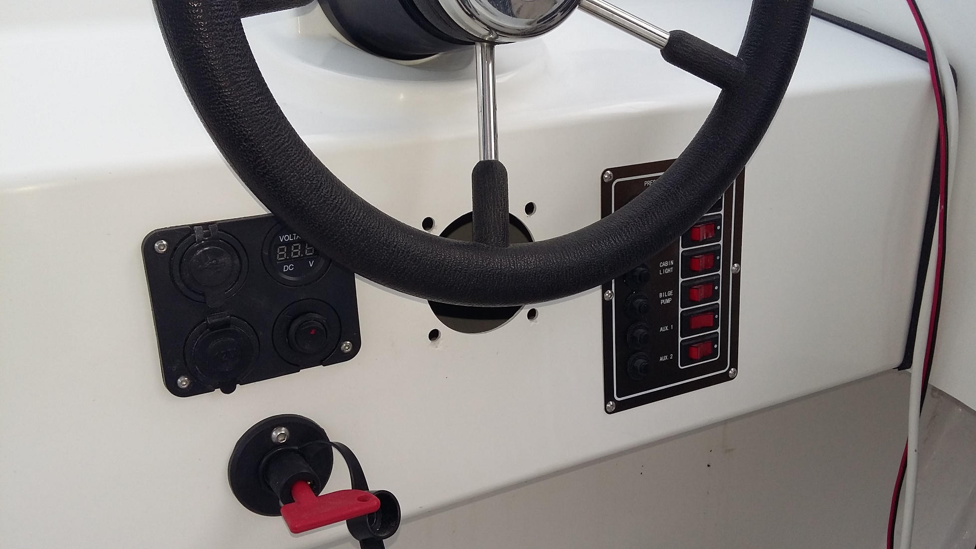

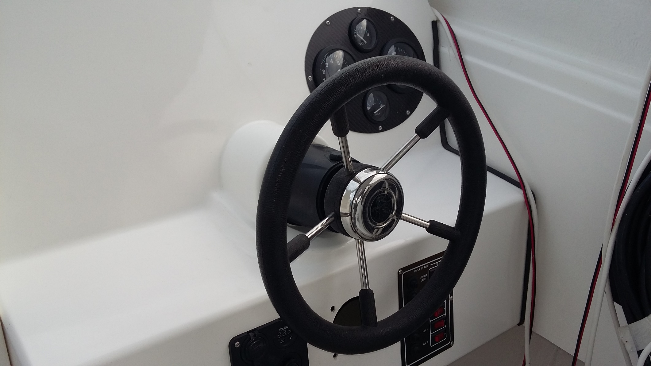

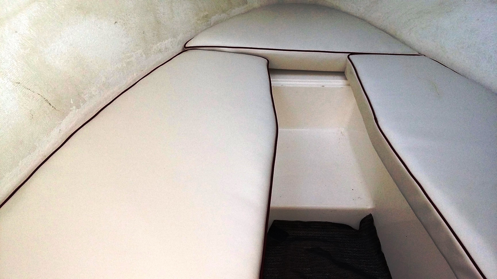

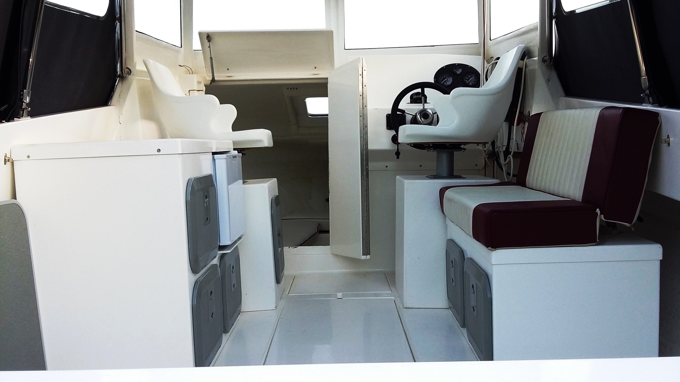

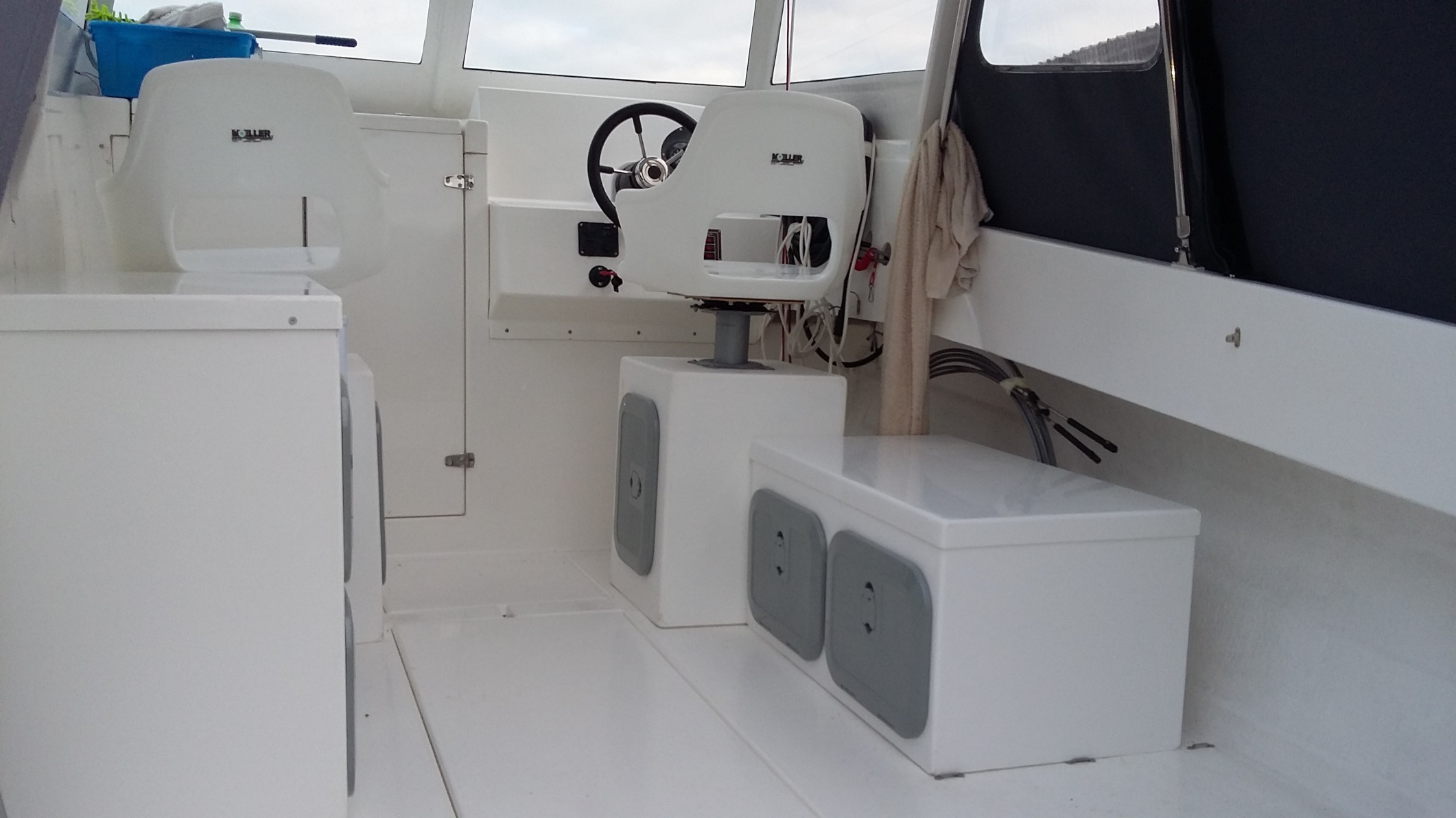

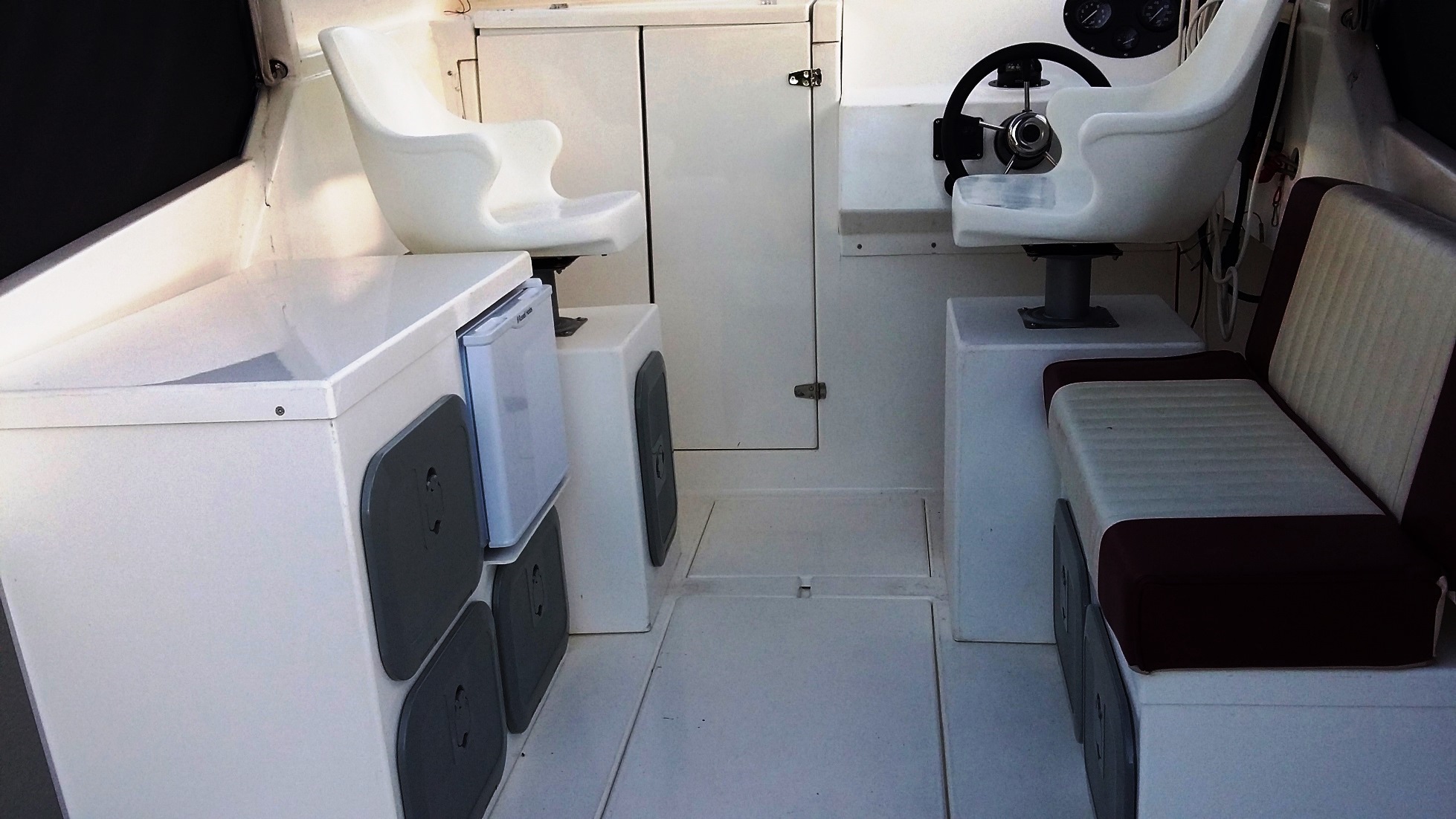

Just a quick update. Wheel house furniture and vee berth cushions now made and placed in position. As the helm unit (Baystar) is hydraulic (not the original intention) it protrudes out a bit more than planned, so I have decided to move the helm up and forward to regain a few more inches WH space. I have made a pod pattern and mould to house the helm unit in its new position and hope to get this fitted in the next couple of days. Geoff.
20190911_182838 53%.jpg (462.62 KiB) Viewed 30168 times
20190911_182737 60%.jpg (436.7 KiB) Viewed 30168 times
20190911_182004 70%.jpg (423.28 KiB) Viewed 30168 times
20190911_181909 70%.jpg (474 KiB) Viewed 30168 times
20190911_182713 60%.jpg (437.54 KiB) Viewed 30168 times

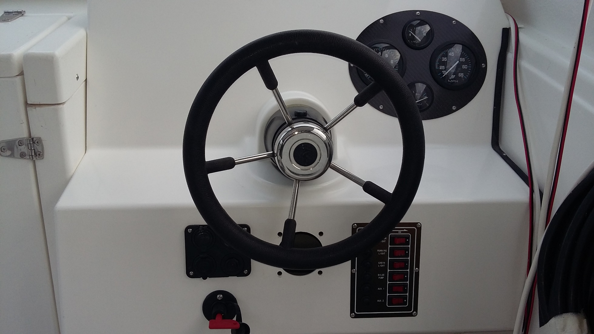

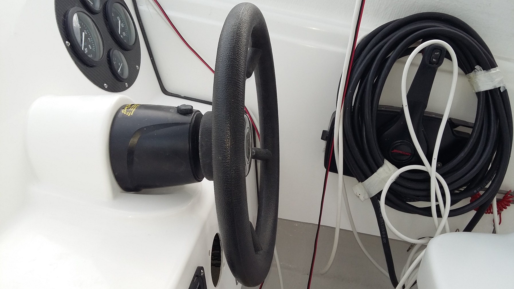

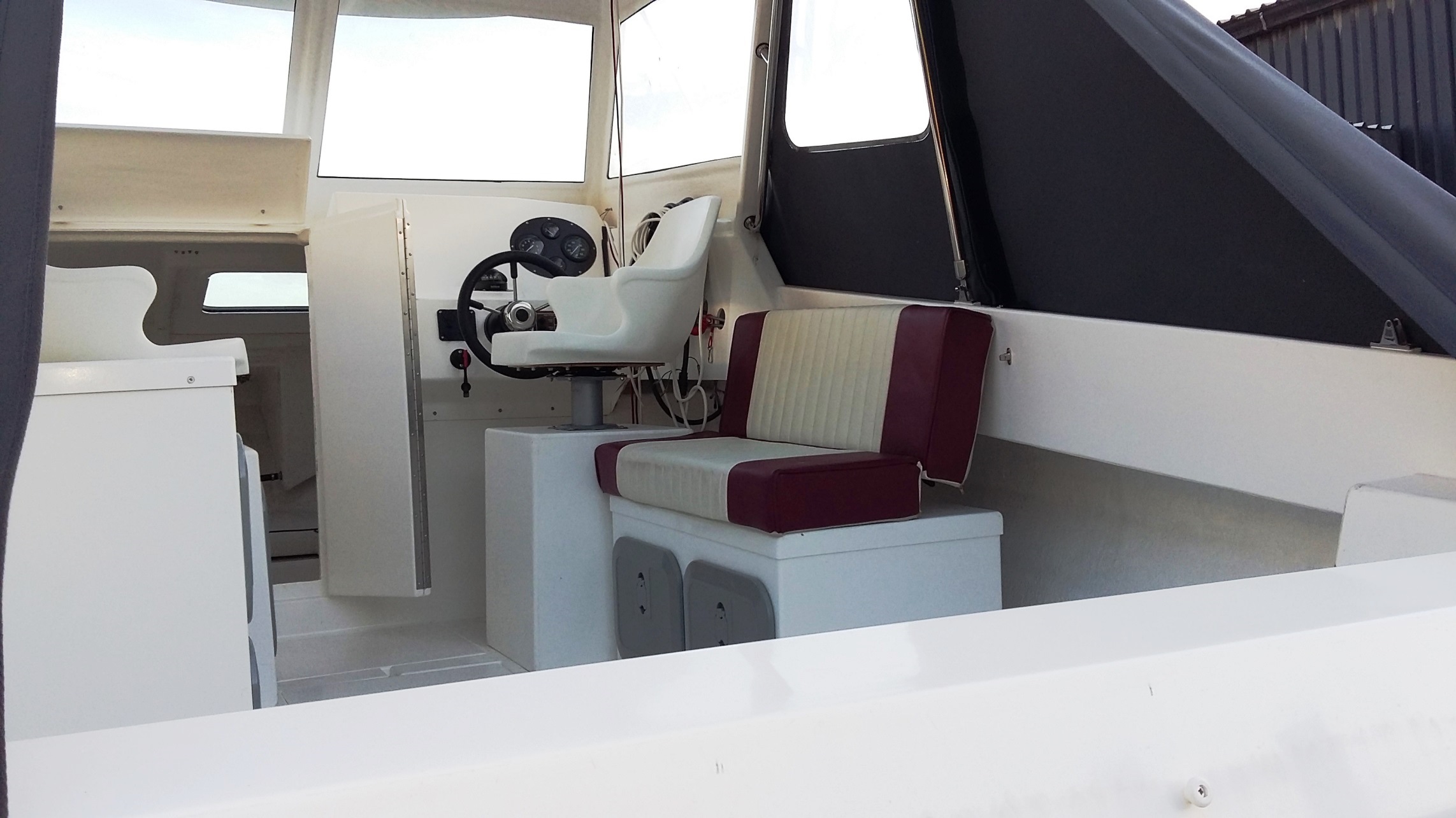

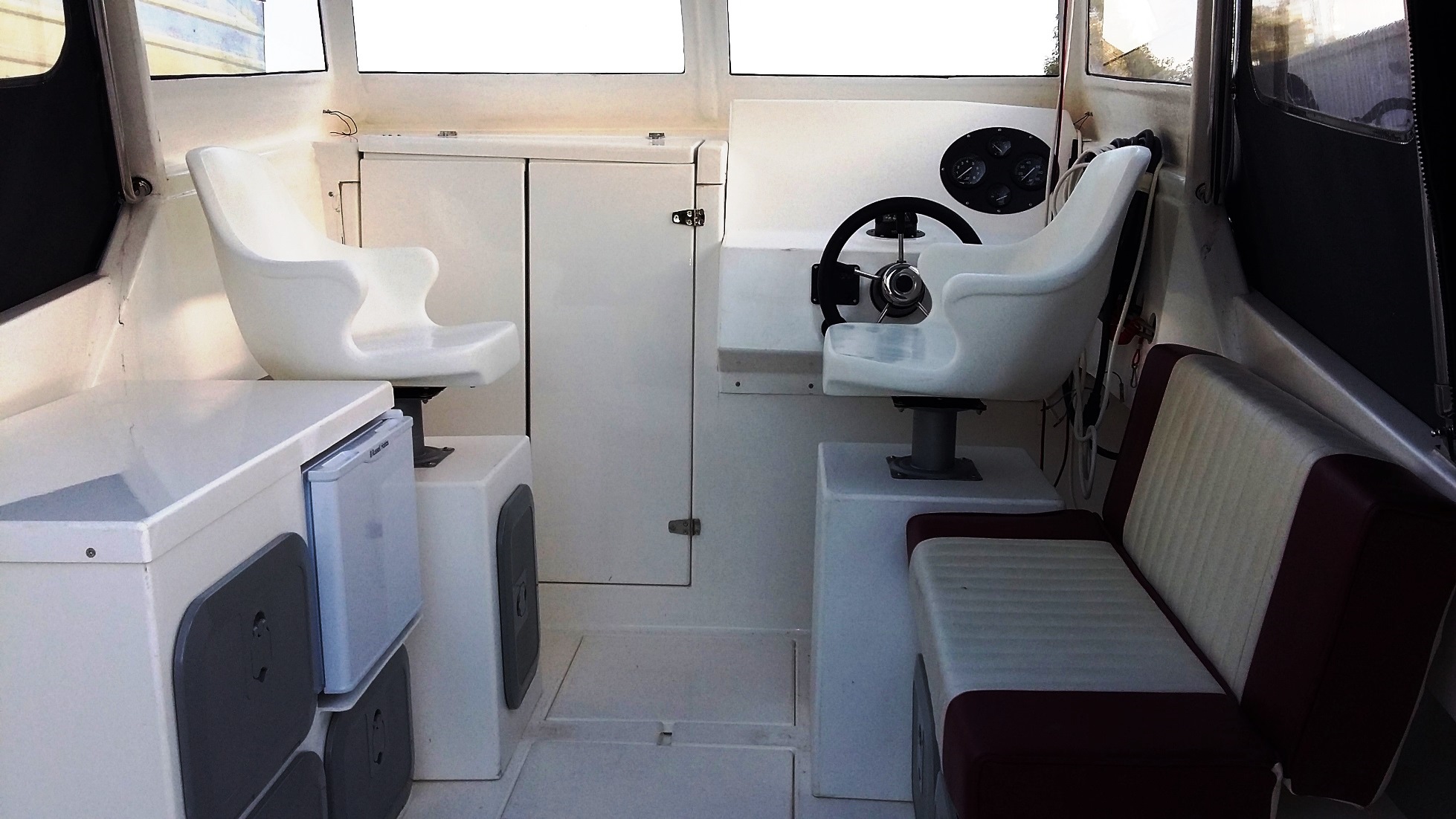

Thanks for your nice comments Ian(BB). Plenty of vans about, so don't give up. We started to prime paint our camper furniture today. Geoff. I also refitted the boat dashboard with the changes to the helm. I have gained 100mm in length and the higher wheel position is also far nicer, but I shall have to find a new position for the compass. Geoff.
20190918_182305 65%.jpg (449.85 KiB) Viewed 30118 times
20190918_180409 60%.jpg (450.81 KiB) Viewed 30118 times
20190918_180351 60%.jpg (479.98 KiB) Viewed 30118 times
20190918_180340 65%.jpg (488.39 KiB) Viewed 30118 times
20190918_180312 55%.jpg (451.02 KiB) Viewed 30118 times
