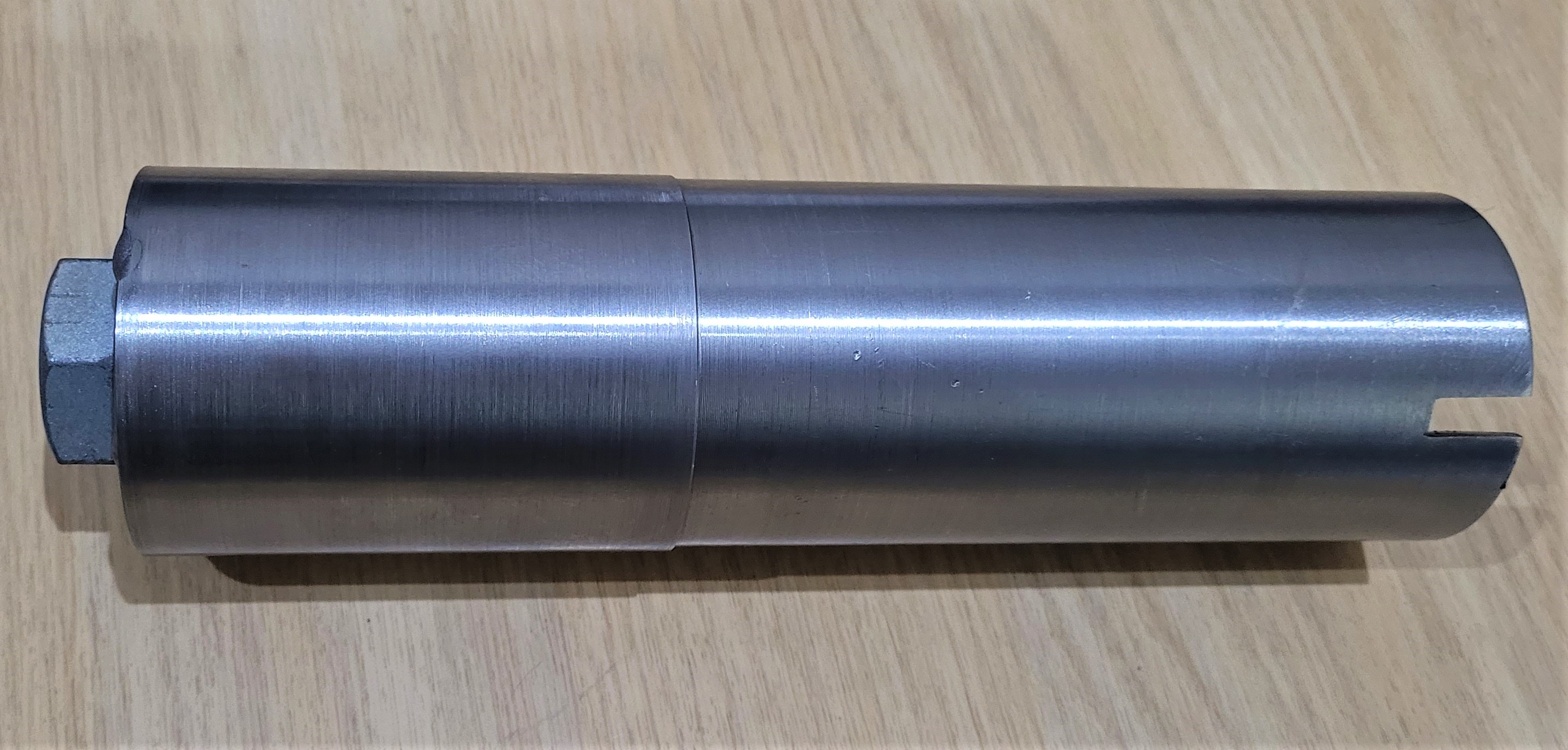

Measurements as below
Inner 52.8
Outer 57.3
Slots are
6.00 approx as they not all the same
by 14.8 BUT they are rounded at the bottom

by argonaut » 27 Jan 2022, 15:13
Didn't hear back from Ian H ... so I made one ..... bit of 50mm pipe and turned to make it same size, and some hacksaw & filing to create the slots.
Welded a 30mm nut on back ... so same size as nut on the rear prop.
