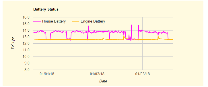

We use a C-Tek charger, an intelligent charger that is rated highly on various Internet forums. Connects to one battery and then waits for the VSR (Voltage Switching Relay) to connect the batteries in parallel.
Being intelligent it carries out the function it senses is required (Rapid Charge, Float Charge, Pulse charge, Restore)
Here you can see it trickle charging the house and when the VSR cuts across giving the engine battery (which is then in parallel) a pulse
