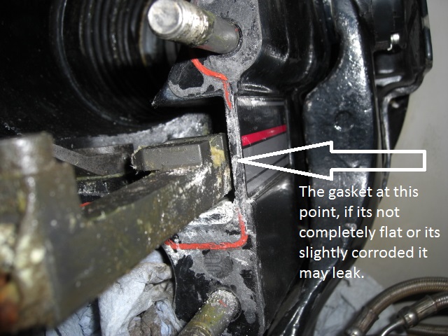

Having said all this, as with any leak, imho...if you suspect an issue its always best to
change it out. However if you have a leak into this area, I would suspect the gasket
between the drive and the bell housing at that point....When you tighten the drive
nuts, very often the gasket squeezes out a fraction, it's such a small strip for the
gasket to squash in, it may go one way or the other. A good dollop of
Marine Silicon will stop water intrusion.

very good Ian you are spot on. If I may explain a little - initially my diagnosis was the gasket
but then after completing the job (by pure chance) I read many online reviews on the
Gen 2 seal failing and causing the leak. Yes Gen 1 was unreliable but Gen 2 apparently
are also prone to failure (although having owned one for 12 years now I haven't
personally experienced or heard of this)
funny you should mention silicone on the gasket at that area you highlighted
- when I refitted the drive with black marine gasket sealant + gasket I noticed
the new gasket fitted would not sit between the 2 drive section at the shift
cable chamber . After 3 refit attempts with more gasket sealant added it would
still sit outside the drive. When the trimming knife came out i soon reached
the point of 'Oh Sh@t' and a new gasket was needed. Luckily my spare
(a quality one not a cheap knock off) fitted first time and sealed as it
should AFTER I removed all the gasket sealant. So theory 1 - either gasket
sealant does not work well in that very thin area of contact acting as a
lubricant or cheap gaskets are not worth the saving.
Theory 2 - My belief is the previous gasket also sat proud at this point
(having been 'told' by the dealer it had a full drive service before
being sold) and caused the water ingress but it is unclear how the
water (without exhaust gas pressure) travelled up the shift cable.
