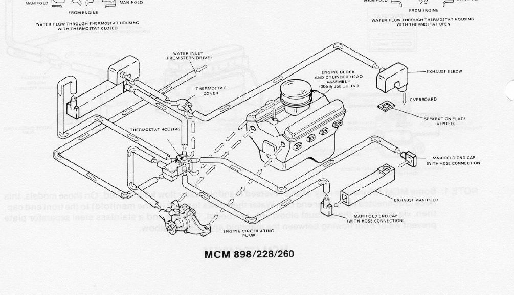

by Ianfs » 24 Apr 2017, 08:49
This is a much older version but the principal is the same.
by shibbs » 24 Apr 2017, 18:49
So with that cooling diagram in mind, i'm really confused as to what will be going through the center port in this picture.. It has definitely had water coming in through it though which is what has caused all the moisture in the middle of the engine / rockers.
I'm beginning to think that water has passed inwards from the exhaust manifold over the valves and into the inlet manifold. The Manifold and elbow (riser) are in good condition but the gaskets were definitely past sell by date and i know water had passed externally. (only now after a considerable amount of reading)
Whats everyone's thoughts?
